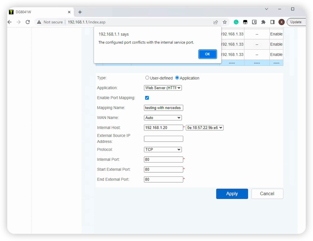

Message 5 of 11
This is a firmware bug that I reported a while back & there is no news of it getting fixed. Just request in your reply to have it swapped out for the reason I have just said. TT will action this & there won't be any charge.

Message 7 of 11
Hi @GalvinBriford
@Chris-TalkTalk has asked me to help you. With the Huawei DG8041W there are a few ports, including 80, that this router will not allow you to forward. The only workaround is to do port translation on the external port within the rule. The best solution is to ask TalkTalk to swap it for a Sagemcom 5364 router, as that will allow you to do this.

Message 9 of 11
Hi Chris,
My internet service works well. However the error message showed "The configured port conflicts with the internal service port.", and this problem started since I wanted to open the ports.
