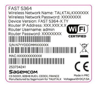

Hi @Jaidaken
@Anonymous has asked me to help you. Which make/model of TalkTalk router are you using? Please can you send me a screenshot of a rule that does not work, so as I can check it for you?
