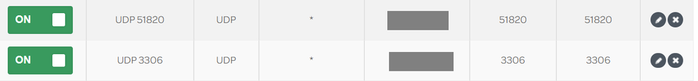

I do have another way of testing UDP ports and I have just tried forwarding UDP ports 51820 & 3306 and they worked the first time. These are the rules that I used:-
