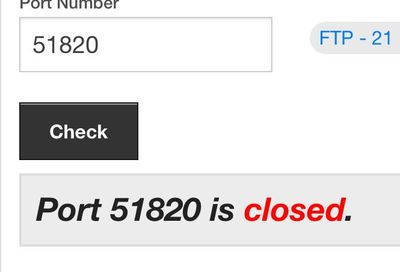

I’m trying to open a port with port forwarding. Port 22 for ssh works perfectly fine, i can check the port and it is open. Any port in a higher range will not open. The settings are identical, the ip address is correct, but it will not open.

So I tried opening them as TCP to see if that works, but still no luck, they remain closed.

  here you can see, 22 works without issue. The others will not.

 Not sure why they didn’t upload, here they are.4D2C3D82-E38D-4E51-8DD1-2F5B62F25CD7.png

The files attached have the ports shown. 22 works fine, the others do not.
