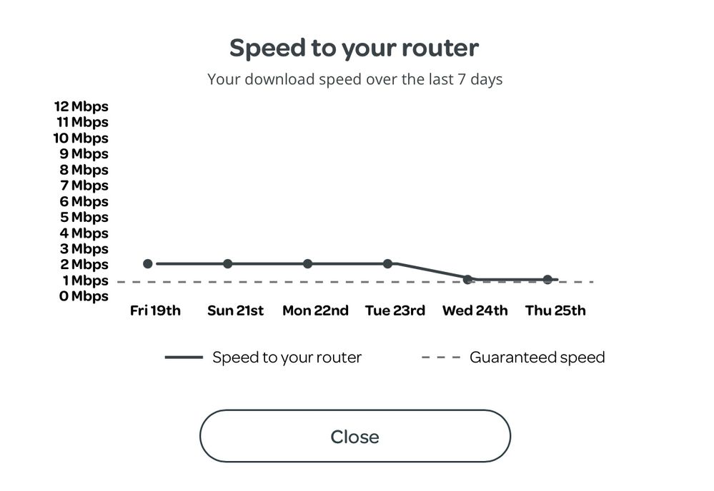

Normally we get a download speed of 2-3mbps via a wired connection, but for the last few days we’ve been around 1mbps. Tests are from the master socket, with no other appliances connected and all sockets have filters. The landline is working fine.
I’ve attached a picture of the speed to the router which might suggest a line issue.
Last time someone optimised the line for us which shot the speed up to 3.5mbps (which is amazing for our location), and then it settles around 2.5mbps again.
Would it be possible to reset the line again please?
Thanks in advance,
Richard

Message 6 of 12
Hi Richard,
I'm sorry, there isn't really any way to stop DLM changing your profile if the error count is high. High errors do cause performance issue though so it usually better to be a slower profile with fewer errors
Would you like me to reset DLM and restart the optimisation process?
Chris

Message 8 of 12
Hi Richard,
it looks as though the line management system (DLM) has moved you to a slower profile because the error count has been high on faster profiles. Are you experiencing any problems with your telephone service, any noise on the line?
Chris

KeithFrench
Message 11 of 12
What happens if you connect the router via a new or known good filter to the test socket located behind the master socket's removable face plate? That will rule out any issues with that faceplate or your sockets & internal wiring.
