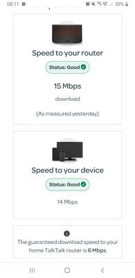

The Service Centre is showing a marvellous 16, and I usually get 12 - 14 on my smartphone.

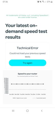

@Debbie-TalkTalk, in fact, I can't take a screenshot of the specific Talktalk speed reading as it only shows both upload and download fir a split second before displaying like this, which is not as detailed.
That is a nuisance, which could also be fed back to the Service Centre people!
All I can screenshot is this:

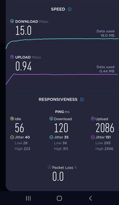

Useful information from my latest separate Ookla test here:
Service Centre is reporting speed to router as 15, which is not what the graph shows as the average of the week: 17.

I didn't take a picture of the actual speed test, just the wonky records bit, but from memory it was 14.8, but on the low side for upload: 0.7.

Service Centre still not storing speed checks, as reported before.  Over a year or so, with Chrome and Firefox,  and with Sagemcom, the old 635 router and this Huawei one.
 I know I am not the only person to have noticed this, but nothing ever seems to be done about it! An ordinary Ookla test on a separate app has no trouble keeping records like this.
I wish the Talktalk speedtests would store the information properly, or just not pretend to offer a facility that never works!
