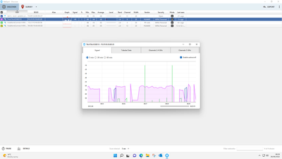

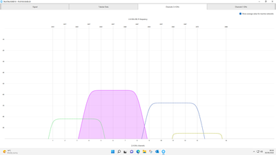

Thanks @KeithFrench Very helpful and thank you for your time. Changing to change 11 solved the problem till last night and we had a straightish line on the netspot (ie ups and downs but no drops out when I looked at it but didn't take any screenshots). Also the Jack speaker disappeared whilst the wifi was working which I think is because it creates it's own hotspot if it doesn't have wifi so it isn't interfering as such.
But since last night we are back to drops outs. The first set of screenshots below is on channel 11. I've then done another set on channel 6 to see if that did anything (but it doesn't).
Is it a just a case that I expect the standard talktalk router to be as good as one you pay for (although from memory I did pay talktalk for this one!)?

on 21-06-2022 10:56 AM
Message 3 of 10
Hi @Anonymous
Yes, it is interference, the speaker in Jack's room is interfering with your Huawei router, as they are on the same channel. I would suggest that you move the router to channel 11, please see my guide on how to do this.
You may also have another problem, it could be caused by the above interference, but I cannot tell as yet. Your WiFi signal is dropping out all over the place. If you look at the signal strength graph, it should be a fairly flat line, but yours keeps disappearing. After you have moved to channel 11 on the router, if you get me another set of screenshots, I can recheck this for you & make suggestions if still a problem.
The most likely reason that you are not detecting any 5GHz Wi-Fi signal is that the device running Netspot does not have a 5GHz compatible WiFi adapter in it.

on 20-06-2022 08:53 PM
Message 4 of 10
Thanks KeithFrench
Not sure I understand the screenshots but it doesn't look like interference to me - mainly as the only other wifi it is picking up is a google speaker which is creating it's own wifi as it can't find the main wifi and only other thing is a vodaphone wifi which I guess is the neighbours but I can't figure out how it can get into our house as I'd guess there router is the opposite side of their house to us. Having said that I'm not sure I'm using the app right as itthe 5ghz is showing as

17-06-2022 10:12 PM - edited 17-06-2022 10:14 PM
Message 6 of 10
No worries @Skynet_TX .
@Anonymous I will PM you a link for a guide of mine on Wi-Fi interference & initially look at the section called "Are you suffering from interference – prove it first". This section includes full details of Wi-Fi analysers that I recommend for Windows, Windows phone, Android and Apple operating systems. However, I have no way of testing the Apple product. Do not worry about interpreting the results, I will do that for you.
Please post the screenshots that I have requested in my guide (no photos please they can be difficult to read as text can get out of focus when zoomed in), from the analyser you are using (also in my attached guide). Please ensure that the analyser window is maximised (if Windows) before taking the screenshots & upload them via the "Insert Photos" button (in a mobile browser it's the picture icon) on the post editor's toolbar with the Size parameter set to Large. If they are too small, I will not be able to read them & although I can enlarge them, this puts the text out of focus. If you prefer PM them to me. If you do PM me, then please add a link in there to this thread, so that I can find it easily.
