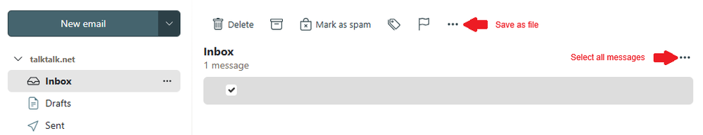

@Billx
I don't usually use webmail, and have not changed the layout. It appears that my layout is set to 'List'.
webmailwebmail

Sorry, @nameunknown
The  " 'Select all messages' in the 3 dots menu on the far right" is the far right of the central pane, the messagelist column/pane of the app, not the far right of the app.
And to go through this, @RigaMortice has to first decide whether he wants to delete and recreate the email address.
Edit: alright @nameunknown , our difference of where the 3 dots are, depends on the layout that the user has set the TalkTalk webmail app to. Sorry. My layout is currently set, so that the reading pane is on the right, rather than below.
Message 9 of 83
@RigaMortice
If you need a method of restoring all of your emails to a newly created account .....
Having consulted with @Billx , I now see there is a way to export emails from webmail, and these can then be imported into an IMAP folder via an email application.
To export Inbox, Sent, etc folder contents, select all emails in the folder using 'Select all messages' in the 3 dots menu on the far right. Then go to the 'More actions' 3dots menu, which is at the end of the row of icons tha starts with the Delete icon. In 'More actions' select 'Save as file'. Save each file with a name corresponding to the folder name, e.g. for Inbox save it as Inbox.zip.
Extract the contents of a zip file into a local folder on your computer. Select all of the files, and drag them into the corresponding IMAP folder of the (new) email account. I am not sure if you can drag and drop them into Office 365 Outlook, but you can definitely drag multiple .eml files all at once into a Local folder or an IMAP folder in Thunderbird.
