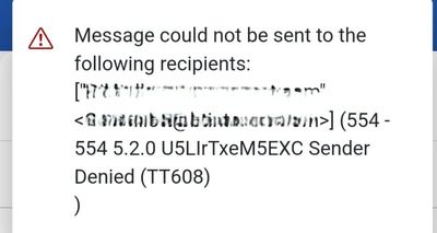

TT608 means that there are multiple logins to your mailbox from geographically distanced locations.  So, my diagnosis of multiple connections from geographically distanced access points is confirmed from the error code. This is the reason for the sender denied error.
Now the worst case scenario is that your email password has been discovered and an unauthorised device is connecting to your mailbox. I asked if you would disconnect all devices that are connected so if you have done that then the next steps are as follows:

Tried 2 different email apps with the settings as shown in the attached pictures. Neither allow me to send emails. When sending via Web browser I get the following message (TT608).
Not connected via any VPNs.
Same thing happens with 2 different email addresses connected to same talktalk account. Neither can send on respective phones.
