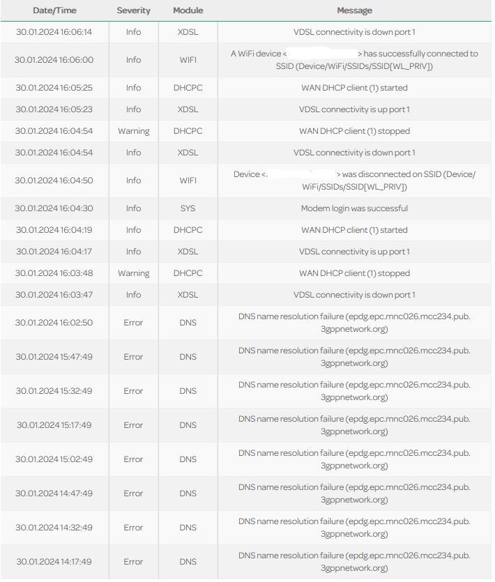

Hi Franco,
Sorry to hear that you've been experiencing problems with your service. Line test is passing but I can see that there were a lot of reconnections yesterday. Looks to have been OK so far today, how is it at the moment at your end?
The DNS errors often just mean that there's no internet connection

on 30-01-2024 05:42 PM
Router Logs
Here's a sample of the router logs that I assume show the disconnections (VDSL connectivity is down). Not sure what the DNS error is, i don't recall seeing that on the WiFi hub.
