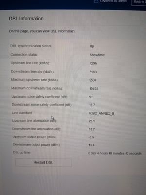

Is my line is stuck in a low banded DLM profile?
The router is syncing at 5 Mbps with an SNR margin of 13 dB.

It does sound like the Huawei router is actually faulty @Cloudy37. Whether or not the speed coming in from your FTTC line is responsible for the 29M download speed, an Ethernet connection should be much closer to that 29M, at least than 2M.
