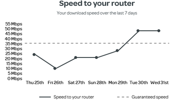

Since last week my speed has been degrading from a steady 40mbps to 3mbps or less (tested on wired connection). This happens over a few hours. If I reboot the router the speed comes back up. The router thinks that my speed is between 45 and 50mbps.  Any idea what might be happening? I don't think that anything has changed on my network.

Just spoken to the engineer. He says:
  • The fault is in the road some way from the manhole cover and cannot be easily fixed. He thinks that it was damaged when the road was dug up. (The last time was when they when they laid fibre).
  • All of the spare lines have the same fault, apart from one which he has given to us. It might be that the fault shows particularly in wet weather because the multicore could be  sitting in water. If anyone else reports problems they will have to close the road and replace the cable.
  • He says to leave the router switched on and it might take 7 days to settle down. It's currently sync'd at 47Mb, but the speed test from my account page shows 20.1Mb at the moment, which is what it was saying before the Openreach visit. Should I power cycle the router?
Thanks for your help with this and I must say the Openreach engineer was really helpful.

Openreach engineer came to the house today (Saturday) and asked to check inside as he was having trouble locating the fault. He eliminated anything my side of the master socket and traced the problem back to an intermittent short 120m from the house. (I'm pretty sure this is the same place there was a problem last year). He said he would need help accessing the cable, I believe it's underground and the access point is in the road. He will return on Monday to complete the job with another engineer.
Since the router was not at fault, do you want me to swap the new one out and return it?

No, I'll swap it over now. Speed the last couple of days has been just about usable (10 to 20Mb) and fewer drop outs, but still getting them.

I've checked the connection stats this morning and the line is in sync at just over 10mb but the test is also detecting a fault.
