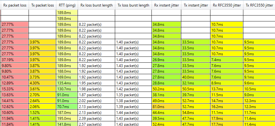

Everything is still the same. I have Packet loss 22% and above coming to the property ONT
Packet  LossPacket Loss

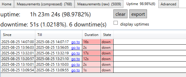

I also have downtime
DowntimeDowntime
I also have RX Jitter in excess of the MTJ
RX Instant Jitter and downtime packet lossRX Instant Jitter and downtime packet loss

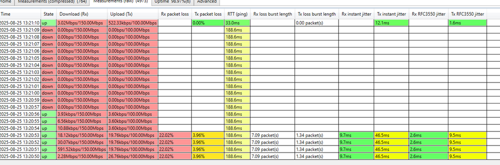

Connection has dropped 11 times whilst writing this
Drop off and Packet lossDrop off and Packet loss

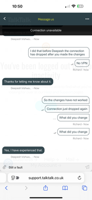

The connection kept dropping when I was on to them
”Connection Unavailable”
cheers. Richard

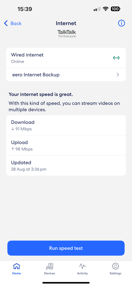

Using the Eero " Run Speed Test app   98Mbps/150Mbps and never get any higher. I pay for 150 Mbps and have 2 New Eero routers.

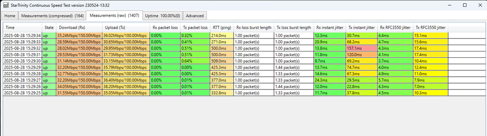

You can see that the
1. ping time is 332.8 ms,
2. Download is 32Mbps / 150Mbps
3. Upload is 35Mbps / 100Mbps
Continous Speed TestContinous Speed Test
As usual the Eero App "run a Speed Test" show a much higher figure LOL  Download 91 MBps Upload 98 Mbps.
ScreenshotScreenshot

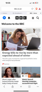

Now we get this Any Ideas? All other devices are disconnected
Superfast Wi-Fi connecting to BBC on Mobile phone, (Get the same on Desktop Browsers)
WifiWifi
No WiFi but Mobile Data only Connecting to BBC
WiFi OFFWiFi OFF
send/receive errors on email too
