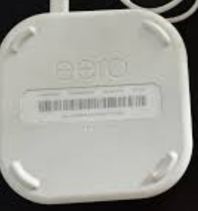

The one you have, pic 1.

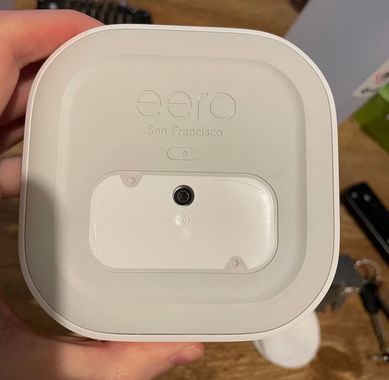

Is that the one in pic 1 or 2.
Message 3 of 13
The model you posted reveals a huge heat sink when you remove the bottom plate:

This is a bit weird mine looks like the one in the top picture with a raised rubber foot  all the way round the edge,  i have seen pictures (see pic 2) with a foot at each corner i assume the never version (if that's what it is) never gets hot enough to need the airflow underneath.

They do run warm, like a lot of electronic devices. If you examine the edges around the bottom you will see that they are slightly raised at the corners, so as long as you have them on a hard, flat surface then there is room for airflow underneath.
