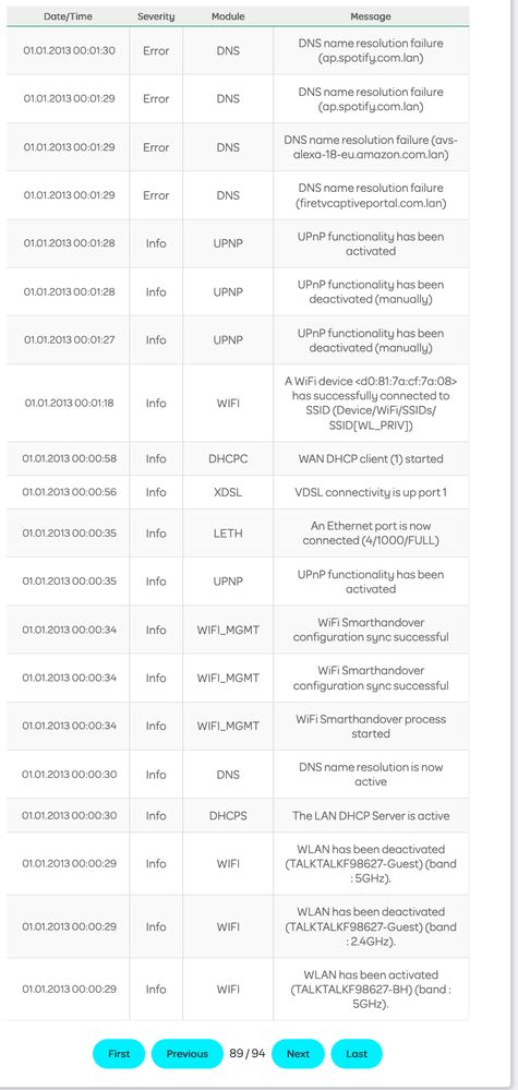

I have just swapped over to Full Fibre 500  (Took just over 3.5 months from initial install date) and was first told I would be getting the super duper eero router.   Now that my install date came I received a router in the post... not an eero
I got the TalkTalk Wi-Fi Hub 3 with Firmware Version: SGEK10004A00
After around 100 minutes, the internet stops working.
Looking in the router admin panel, the connection still says its connected, but it just isnt working on any device, wired or wireless.

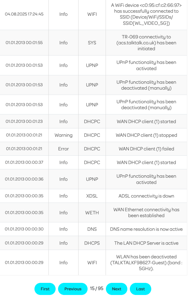

So I have gone to the logs in the router to see if that helps and I see the following (See pics)
It looks like somebody has been having problems with this router in 2013. Im guessing its then been sent back to talktalk for a replacement and they have sent me this faulty router.
The only way to get the internet working on my devices again is to restart the router, it works for around 2-3 hours and then the same error happens.. All devices yet again dont work, and the router light is still lit and says connected in the router admin panel.
The majority of the errors are pointing to the DNS resolution failing.  I checked in the DNS settings and somebody had entered 192.168.1.1 as the DNS server, which is the router IP so wouldnt achieve anything..  I have removed that IP and the error is still there.  This leads me to believe that the last person was experiencing the same issue that I am now getting.

Thanks for that. It is 100% the case that, as the Hub 2 tracert is perfect, the one from the Hub 3 connection shows a network issue. The hub 3 in your tracert takes a different route from the one with your Hub 2. The 2nd hop (the first router in the TalkTalk network after yours) is different:-
Hub 2:-
1 1 ms 1 ms <1 ms 192.168.1.1
2 4 ms 4 ms 5 ms host-92-28-192-1.as13285.net [92.28.192.1]
Hub 3:-
1 <1 ms <1 ms <1 ms ttrouter.ip [192.168.1.1]
2 * 89.242.201.205 reports: Destination host unreachable.
The only people who can resolve this are the TalkTalk Networks team. I think with all the discussion about why you have been supplied the incorrect Wi-Fi Hub 3, it looks like I might have forgotten to ask for this to be passed over to the TalkTalk Networks team. Apologies for that. Please can you do this for me @kanya-TT via your team leader? Thanks.

IP packet data flow is stopping, both your tracert and Wireshark trace have proved this. It is a network issue, as I said before. The one thing I can't answer is why this is not affecting the hub 1, unless it is using a different route through the TalkTalk network. If you are still connected to the Hub 1 currently, please can you get me another tracert to the same destination IP address as per the Hub 3 connection.

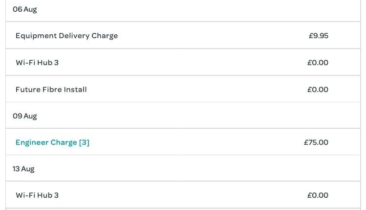

@MerseyRayUK Have you received the router as yet? I have looked into the account, and I am unable to see the full detailed synopsis behind the charge, I would suggest that you contact the full fibre team so that they can see the reason behind the charge and help you with it.
