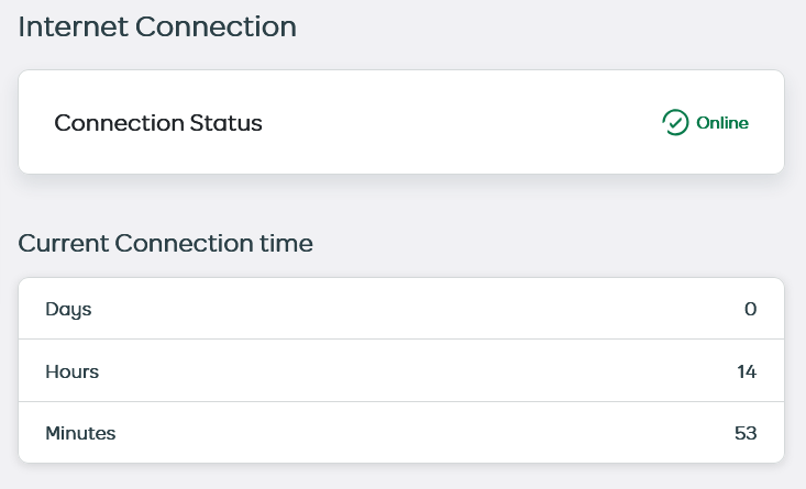

After around 100 minutes, the internet stops working.
Looking in the router admin panel, the connection still says its connected, but it just isnt working on any device, wired or wireless.

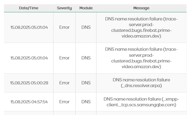

So I have gone to the logs in the router to see if that helps and I see the following (See pics)
It looks like somebody has been having problems with this router in 2013. Im guessing its then been sent back to talktalk for a replacement and they have sent me this faulty router.
The only way to get the internet working on my devices again is to restart the router, it works for around 2-3 hours and then the same error happens.. All devices yet again dont work, and the router light is still lit and says connected in the router admin panel.

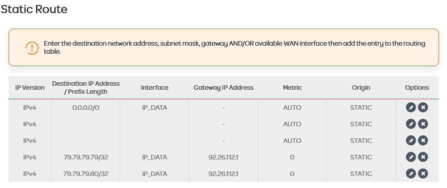

The majority of the errors are pointing to the DNS resolution failing.  I checked in the DNS settings and somebody had entered 192.168.1.1 as the DNS server, which is the router IP so wouldnt achieve anything..  I have removed that IP and the error is still there.  This leads me to believe that the last person was experiencing the same issue that I am now getting.

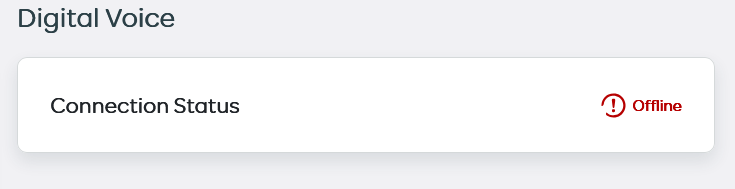

Another update for TT Tech:
So I restarted the router to post the above info.
Around 40minutes later, the internet stopped again
This was around 9:18
I logged back into the router and internet said "Connected", and the Digital phone said "Online".
I tried calling the landline and it seemed to be going through as it was ringing on my mobile, but the landline didnt ring.
At this stage, the light on the front of router was still white.
MerseyRayUK
Conversation Starter
Message 68 of 134
This update is mainly for the TalkTalk Tech guy that is ringing me around 12 midday
After speaking to you, we didnt use the internet much and the internet was working fine from when our call ended right through till 5.01am.  (I know this because that is when the Ring doorbell stopped working)
Walkind down the stairs I could immediately see the purple light on the front. (The phone is connected in the port but the router says "Offline"
The Internet in the router still says online
The DNS erros captured at that time are these
And I dont know if this is of any use
Whilst I was capturing these screenshots for you, the light wsa purple, but then it briefly changed to green, then went to white.
But the internet was still not working and the phoneline still said "Offline"
@KeithFrench I have sent you the information requested.  Check your PM

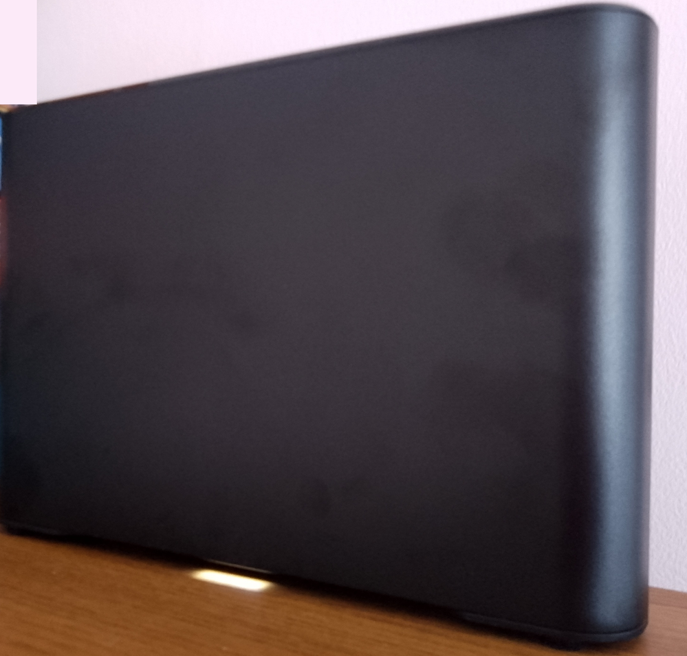

Ahh well all 3 of the routers I have look like this.
I just phoned talktalk CS to tell them I have the wrong router being sent out and they said the hub 3 looks like the one in this picture and has the light on the front.  And she insisted that I had been sent the Hub 3

Is this what my router is supposed to look like  ?  (google image)
None of mine look like that.

There is no need to set static IP addresses on the devices themselves, as that will lead to even more problems. If you want them to retain the IP address, then use the DHCP reserved IP address feature in your router.
Where the DNS entries are concerned is different. Generally, what is happening is that the DNS server in your router (it often gets this information from DNS servers further up the DNS hierarchy) is reporting that a website URL cannot be resolved to an IP address. This is essential from the point of view that website URLs cannot be routed over the internet; only IP addresses can. However, this often does not mean that the problem is with your device, perhaps requesting the IP address of a misspelt URL. The requested webpage is likely to have loads of links in it, which, if not correctly maintained, could be out of date and request other websites that no longer exist.
The main thing about the DNS entries in the system log is that they are wrongly classified as"Error". System logs conform to a series of standard classifications, including error, warning, informational & debug to name a few. Some of the uses for these are:-
  • Error - used when a router is malfunctioning in some way
  • Warning - record when the internet goes down, or some other link (more common on commercial routers or switches).
  • Informational - tells you when something has happened that might be of interest or not. This is often broken down further by the area of the router that has raised this event. Wi-Fi, for example, can be used to identify when a device connects or disconnects from the router. System - when a device logs into the router's UI. DNS should show errors with the DNS process.
  • Debug - record issues with experimental features.
Each of these classifications is prioritised; error, for instance, being of higher priority than warning, because the router is misbehaving in some way. Warning is of a lower priority, because this might only affect some users, whereas a failing router affects every device.
The problem with all of these DNS entries is that they should be classified as Informational; however, being classed as Error, & therefore of higher priority, they swamp the log. I have been stressing to TalkTalk that this is a bug & I am waiting for it to be fixed.

The Hub 3 has a light underneath ?
Both of these routers which I have been sent have the light on the front, there are no lights underneath.
The old router also has the same light on the front but just not as bright.

When the LAN stops working, I check the logs and there is nothing to say anything is disconnected, just all the DNS errors are there.
Why would the logs fill with DNS errors on here yet not 1 on the old router.
One of the DNS errors points to the service that provides the SSL connections to websites, which seems a big issue for me.
