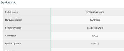

Hi @MerseyRayUK
Yes, V4A00 is the current firmware version, but the hardware version is incorrect. The person telling you that yours is the most up-to-date Hub 3 is wrong. @Lorrainef, who is the manager of the TalkTalk support staff on here, knows which one is the latest. This has also been confirmed by the TalkTalk Devices team, who look after all TalkTalk routers, that mine is the current hardware version. Please get me a screenshot under the maintenance section of the initial Device Info section.
Keith

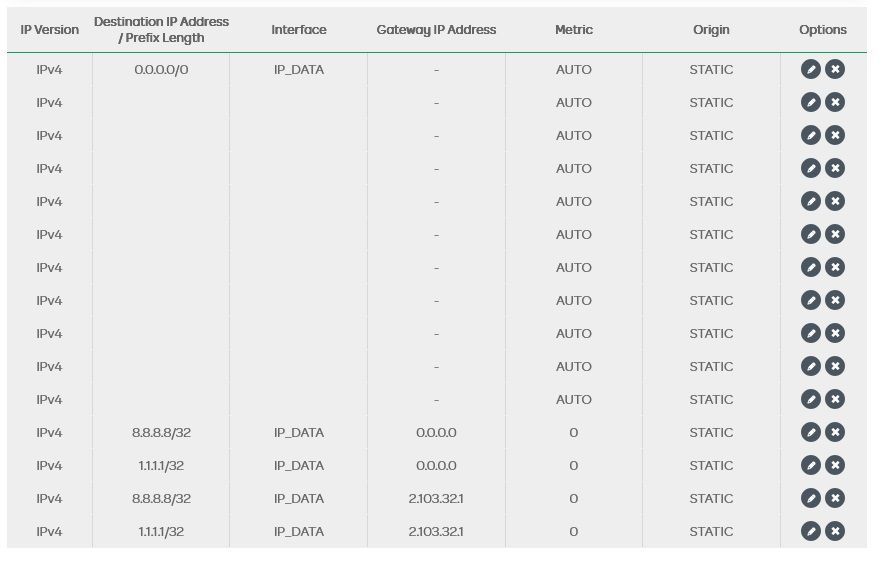

Message 48 of 134
Yes that is where I changed the DNS.
Then I rebooted the router and checked that route table. I havent touched anything in there
KeithFrench
Message 49 of 134

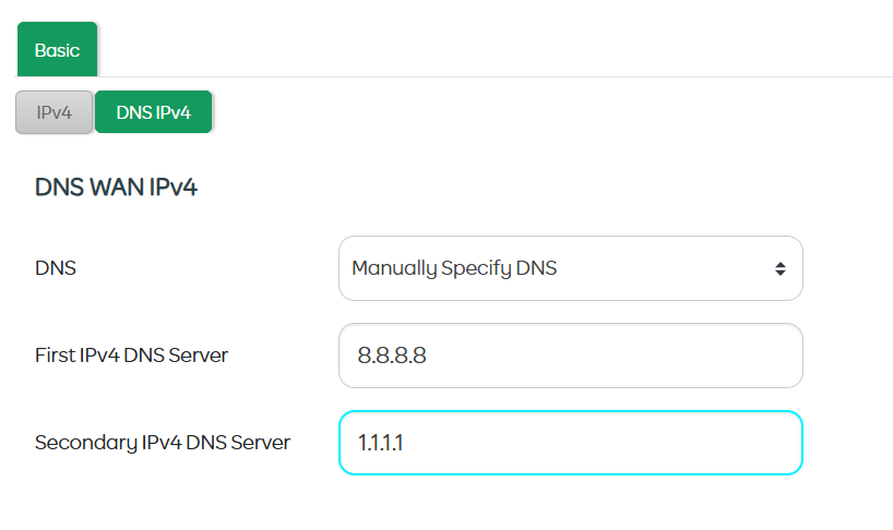

No, you do not make any changes there. Please restore all of your changes. Go to:-
Advanced Settings > Internet Connectivity DNS IPv4 & change it there:-
Network DNS serversNetwork DNS servers
Keith
Message 50 of 134
I have changed to those DNS to see if that helps at all.
Here is the routes on the router.   Is the top one at 0.0.0.0 ok? Or should I delete all but the new bottom ones?
RouteRoute
Message 51 of 134
I will manually set the 2 DNS at these and see if it stays up for longer.  I will reboot the router now to get it connected.
8.8.8.8
1.1.1.1
