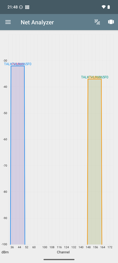

Thanks for the screenshots, there are two obvious problems here. One of your Eeros is using channel 149, not all 5GHz compatible devices support this channel or higher. This probably accounts for slow speeds unless close to the main Eero, if that is the one using channel 36.
The second issue is that there is no 2.4GHz band, while this suffers much more from interference than the 5GHz band, the 2.4GHz one can sometimes have a better range, but this all depends on your local area. I suspect that you have not enabled legacy mode in the Eero app, or did you keep it disabled by design?

Only my Talktalk SSID’s show in the WIFI analyser. See screenshots attached.
