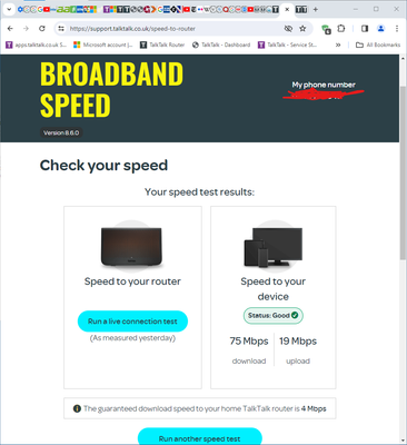

The 'Run a live connection test' still does not work as it should.
Here's the screenshot after  requesting a speed test:
Notice, the above response appears in the page, 'https://support.talktalk.co.uk/speed-to-router'
But the actual response says, this is my 'Speed to your device'
So, the first question is, according to TalkTalk, are these 2 speeds the speeds to/from my device or the speeds to/from my router?

The question in the title of this post, 'Run a live connection test', is that, this button or command does not work. When using the 'Run a live connection test' button, I get,
An hour or two ago and yesterday, I got,
This is the message I got after a long 'livechat' with TalkTalk head office yesterday afternoon, who said everything was now resolved. I note that the date on this message is 17:47 on 03/04/2024. This was the original time/date that this issue was raised, by TalkTalk themselves. There are no additional updates after that date. It seems that the 'livechat' people, simply changed the 'Status' from open to closed.
Can TalkTalk please fix this, so I can do a proper 'Run a live connection test'.

This starts the Speed Test, without showing any speed clocks.
After, it runs the test, it displays the following:
As it shows, it displays only the download Speed from TalkTalk to the router.
It doesn't display the upload speed from the router to TalkTalk
It also has made a mistake in my guaranteed download speed.
It should be 55Mbps. It shows only 4Mbps.
If you also want, Speed from TalkTalk to the devices, click 'Speed to devices' above.

As I said previously, I used both TalkTalk speed test and https://www.supportal-test.co.uk/  speed test, and the 2 of them appeared to be the same, and the 2 of them gave very close results, the TalkTalk one under 'Speed to Device'.
The TalkTalk speed test provides its results under 2 headings, 'Speed to Router' and 'Speed to Device'.
The 'Speed to Router' result is worse than inaccurate.
Bill

The inbuilt speed checker is half right. It shows the correct 'Speed to device'
It still can't get the other half right, 'Speed to router'
I have also tried the https://www.supportal-test.co.uk/ . It seems nearly the same as the TalkTalk one, the half of it that works.
Bill

 On the TalkTalk speed test page it is supposed to display 2 types of results:
'Speed to your router' and 'Speed to your device'
I have already been given 'Speed to your device' as 75/19, I am still waiting to get 'Speed to your router'
I assume these 2 speeds are from TalkTalk.
Now you say, that the 866.7 is the wireless speed from the router to the device. So since I am limited to 75 download, I might as well have a much lower figure than 866.7, and 75 would be sufficient between router and device?
You mention 'massive overheads in WiFi', but surely they won't be more than 20%.
Thanks Keith

Those speeds from the netsh command are nothing to do with the speed to & from TalkTalk. These are the data link speeds over WiFi, what this means is that this is the speed between your PC's WiFi adapter & your router. This does not mean that you can send data at 866.7Mbps to the router either. Due to the massive overheads in WiFi, the actual speed to or from the router will be much less.
A speed test from your PC to the internet will be limited by the slowest link in the chain. In your case, the fibre speeds of almost 80/20 limit the speed to an internet speed test site..
