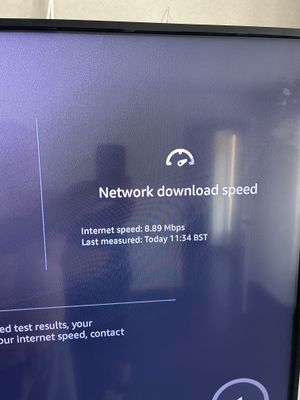

Hi Keith
just done a speed test on my tv and it’s saying 8.89 mbps

Can your TV do a speed test, that could test the eero to eero connection like that?
