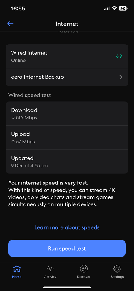

the eero app itself is reporting 10mbps which is still far below what I’m paying for.

One big issue is the Eero router reports really good speeds and the talktalk supervisors log in to my eero and look at that and say everything is fine 😂
but exactly 1 minute later a single device connected directly to the ONT has such a wildly different speed. Confirmed by multiple engineers that have visited now

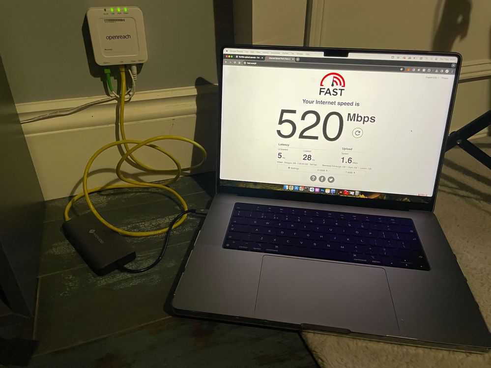

Anyway back to it. with just a single device connected directly to the ONT you can see the issue with the upstream. attached a photo as i cant think of any other way to properly illustrate this (this is also a differnet cable than used with the eero router so it isnt a cable issue) 😅

  • Openreach engineer attended 1st December and was only really able to go through the above. and they tried with their laptop and was getting the same results
