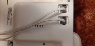

Message 94 of 111
Was difficult to remove front.
Have stuck phone bit in like this:

Message 96 of 111
So phone only.
Will try.
