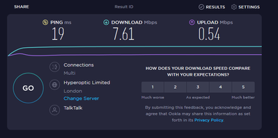

Ever since I was shifted to FTTC about two years ago my speed has been a pleasingly consistent 35+Mbs.
However last night (28.04.22) I realised my speed had dropped and when I checked it was showing almost 50% slower at 19Mbs. I turned the router off and on again, as is recommended practice, and it immediately went back to the 37 - 38Mbs I usually get.
Today I've just booted up and I noticed immediately the speed was low and when I checked it I was disturbed to find it at 7.3MBs with the upload speed of 0.5Mbs, actually less than when I was not using FTTC.
Almost needless to say that there have been no relevant or any other changes at all my end and my experience is this sort of thing is always an external problem - wire to cabinet, cabinet, and most likely the connection to the exchange or an exchange problem.
I spent over six years on ADSL 'copper cable'' broadband with speed drops at least a couple of times a year and went through all the disruptive, tiresome and ultimately pointless checks on each occasion just to prove it wasn't a problem my end. It never was.
The fact I've been getting consistent 35+Mbs for two years, maybe longer, even though the equipment I'm using and the wiring in my house to the master socket was and is exactly the same pretty much proves I was being given the run around as to the cause of the poor speeds for that six plus years before.
So whatever it is this time I can be 99% certain it is not a problem my end unless it is the router which TalkTalk provided me with. It is the same one that was giving me <2.5Mbs the time I last complained about the speed before FTTC was enabled and which 'magically' without any changes has given me the consistent 35+Mbs ever since up until now.
The fact it reconnected at 37+Mbs last night also suggests it is not the problem.
