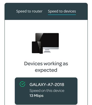

- Highlight
on 11-05-2022 01:21 PM
Message 138 of 169
Thank you, @Debbie-TalkTalk.
Instead of blaming my devices, Service Centre now says there's nothing wrong there!
Given that the only change we have made was the firmware, why does Service Centre not point the finger at that when it's wonky, but rather everything else but the culprit?
Not a good diagnostic tool!
I'll leave this on now until the other router arrives tomorrow, so you will know that any disconnections that happen between now and then are this router, not me switching it off!
Probably still worth checking when I have got the new one set up, and then if all is OK with both, after a few days will need to decide which one to send back, and keep a record of sending....!
Feeling more hopeful about this evening's lesson!
For the record, which firmware am I currently on, and how can we avoid this happening again, if this indeed is the resolution to the problem?
It was quite traumatic at its worst and so that buggy firmware needs to be avoided at all costs!
