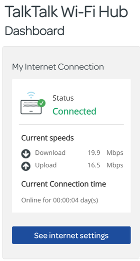

on 05-11-2023 09:17 PM
updates :
The internet totally disconnected since around 7PM this evening, the light flashes amber slowly, sometimes change to white but only last for few minutes then back to amber.
basically we are not able to use internet now.
on 03-11-2023 02:50 PM
Thank you Karl that is understandable.
However I'd like to give some updates here in order to providing some information for you to trace issue.
firstly the connection was down 5 minutes ago
03.11.2023 14:38:15 | Info | XDSL | VDSL connectivity is down port 1 |
secondly now the speed became extremely lower at under 20Mbps

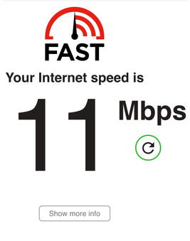

on 02-11-2023 10:32 AM
Hi,
I use the replacement router for one day now, there were two times of the dropouts in past 24hours, looks like better than the old one but still not Zero dropouts.
right now the connection speed is low at 39Mbps, fast.com says the same.
So there is still something wrong, please help
