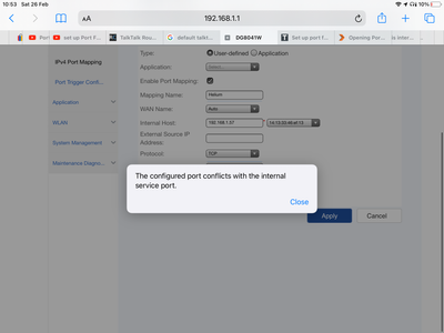

Hi @KeithFrench ,
Can you please help me, I have an issue with port forwarding. I followed what you have put on your screenshot for another post related to port forwarding 44158. But I am getting the message as on the screen shots below. I do not know what I am doing wrong. I am not that tech savvy but trying to learn things as I run into them.
I just received my miner and was trying to set it us when I ran into few problems and this is one of them. Your help will be much appreciated. Thanks

on 02-03-2022 08:23 PM
Hi @KeithFrench ,
Thanks for the advice, i re-set the router to factory default and it worked. Now I need to figure out why I am getting the below message when I am setting up the bobcat helium miner:

on 26-02-2022 02:49 PM
HI @DamKan
There should be no problem forwarding this port at all, I have tested it many times for people using this router & never once seen this error with this port. Please can you try a factory default of the router's configuration & let me know the outcome?
