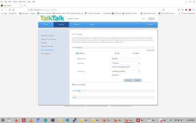

I am trying to set up port forwarding on a Huawei HG633.
I have followed the user guide and believe I have the settings correct yet I cannot make an FTP connection.
I have seen other people having similar problems with Talktalk routers, is this a known issue with this model?

Hi Keith
Are these the screen shots you require
on 01-07-2022 02:47 PM
Hi @Studiosoft
@Anonymous has asked me to help you. There is no known issue with the HG633 & FTP port forwarding. If you would like to describe your scenario to me in as much detail as possible & include the port mapping & application screenshots so I can check them for you.
