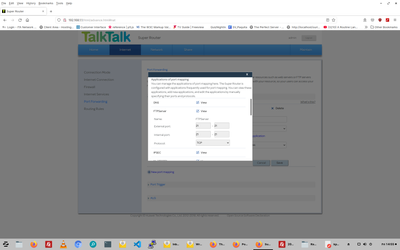

Message 19 of 22
Hi Keith
Are these the screen shots you require

Message 20 of 22
Hi @Studiosoft
@Anonymous has asked me to help you. There is no known issue with the HG633 & FTP port forwarding. If you would like to describe your scenario to me in as much detail as possible & include the port mapping & application screenshots so I can check them for you.
