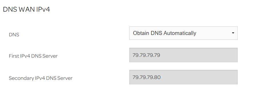

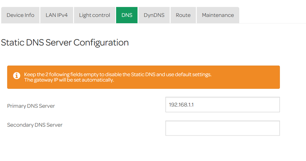

Hi Divsec,
Please see attached screenshots for DNS settings from my house router, the fields are blank on the second router.
With respect to the Primary DNS Server field being populated but the warning message indicating it should be blank, can you advise (the house router currently works fine so I do not want to break anything!).
Thanks,
Adam

Divsec
Message 19 of 20
Hi @AdamC3 what are the current DNS settings in both routers?
