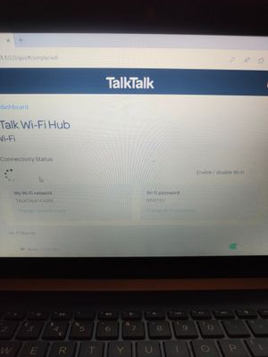

Hi guys for the past hour and a half I have been stressing as there was no WiFi. I was following talktalk instructions (see pic) trying to improve my WiFi connection to my phone. I ended up clicking disable to band 1 2.4ghz as it said try the second band as that was 5ghz. Anyhow that's when it all started it froze then bam no internet. I tried EVERYTHING support was closed it was 2:30am. Nothing worked and no-one had a simple solution. I had connected my laptop via cable from router to access internet settings. In the end I thought no harm let's reset router mind you I had turned it on/off a few times. At the back of your router there is a small hole. Get a pin and push it in and hold. You will feel like you pushed a button. I held it down for 30 seconds. I literally had no hope after the lights settled WIFI CONNECTED. I rather have poor speed then none so I'm not trying anything alone again. I will attach some very poor quality pics to give you an idea of what when on.

There is a bug in firmware V174 in the WiFi hub that when either WiFi band is disabled, they do not recover correctly when re-enabled. The only way around this currently is to perform a factory reset of the router's configuration. This can either be done via the reset pin on the back near the power connector, or in the GUI by going to:-
Dashboard > See internet settings > Manage advanced settings > TalkTalk Wi-Fi Hub > Maintenance > Resets
Then choose the Factory settings reset.
