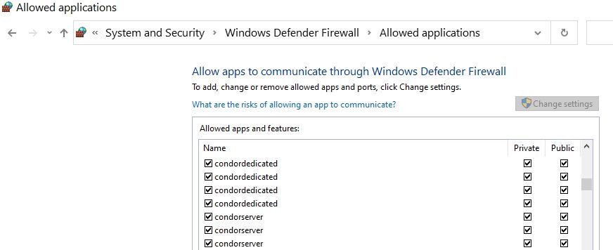

I think I have solved the problem by setting Windows Defender like this:
WindowsWindows
I don't know why condor and condor dedicated appear on the list multiple times (maybe because I have a few versions of them on the HD), but I don't care as long as everything works. It is weird that with my previous settings where condor was allowed on one type of network but not the other everything worked, but with the new router it stopped working. But I am glad that it is fixed now and everything seems to work the way I wanted.

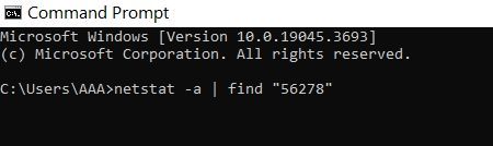

I am sure you can tell I am not a networking wizard. I have no idea what the difference between TCP and UDP is, so I don't know which one Condor dedicated server uses.
After running netstat -a | find "56278" in the command prompt I get nothing...

When you get to this part, please issue this command prompt command:-
Then PM the screenshots to me.

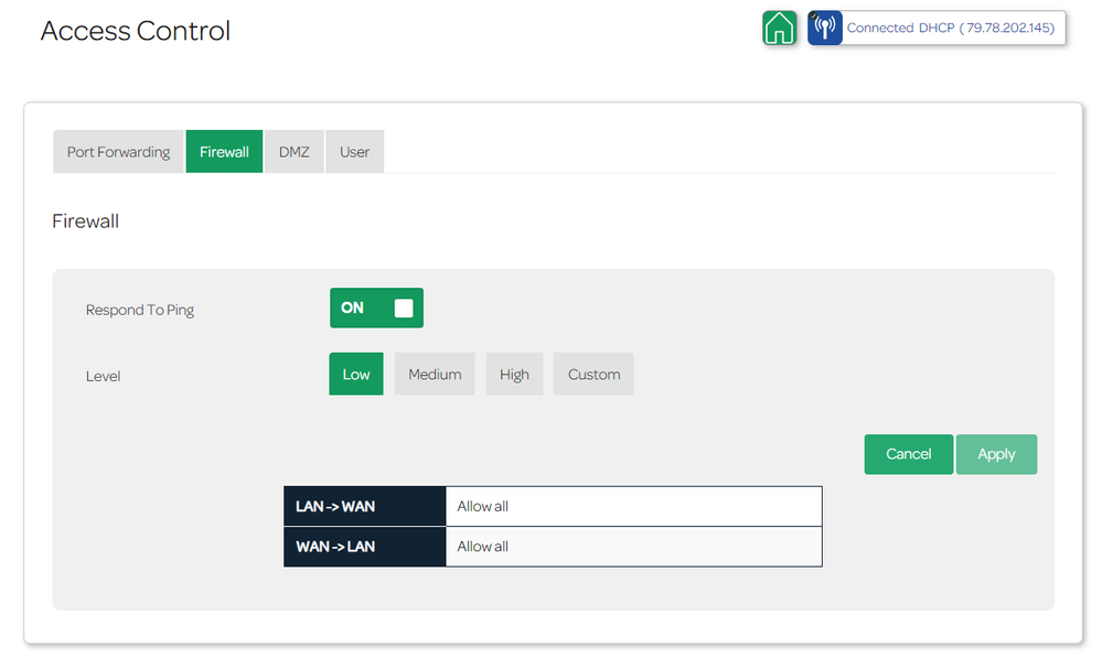

I have put the firewall back to medium and I have replaced UDP and TCP forwarding with just one UDP-TCP. with no effect.

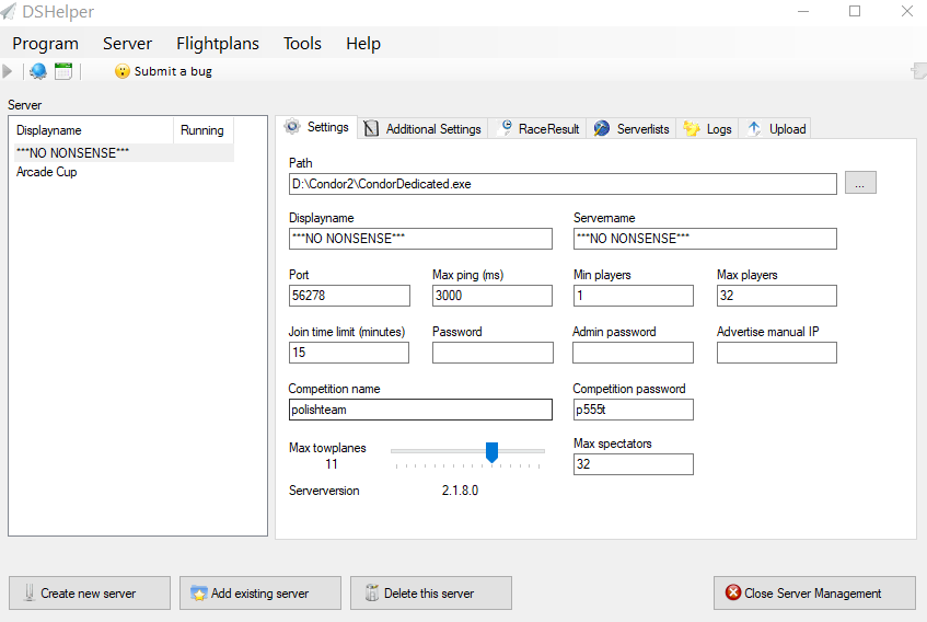

The game I want to use (Condor Soaring Simulator 2) has 2 ways of setting up a multiplayer server. One is from within the game, and If I start the server from the game everything works and people can connect to my server.
Condor also has a dedicated multiplayer server app that allows you to start the server without actually running the game. Before I got my new optic fibre connection and new router/hub I had no problems running this dedicated server app and people could connect to my server.  Now with the new hub I can host from the game, but not from the dedicated app despite the fact that all settings and port is set to be the same on both! My problems started after I got the new connection and hub.

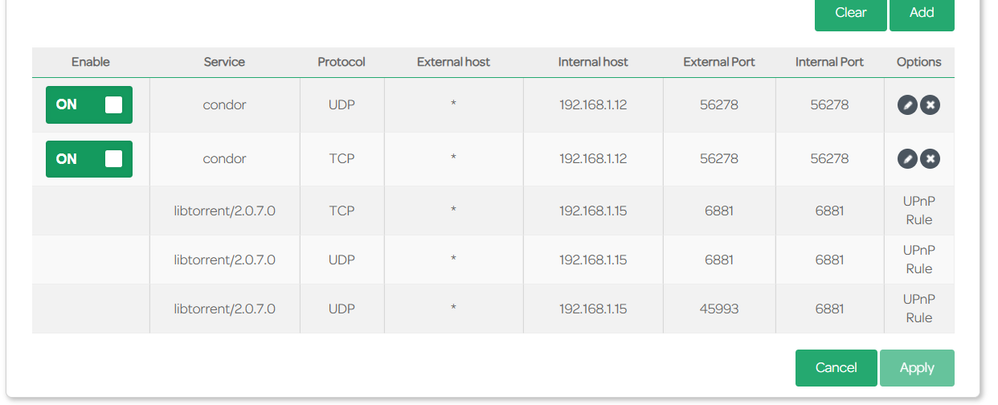

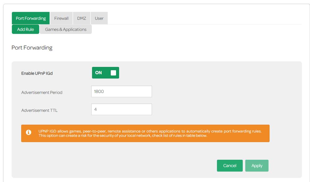

OK, put the firewall back to medium, there is no need to change that at all. I have just tried this on my 5464 & the TCP port reported as open on my first attempt. Have you tried a port-checking website for that? I used one PF rule & just set the protocol to TCP-UDP, which saves needing two separate rules.

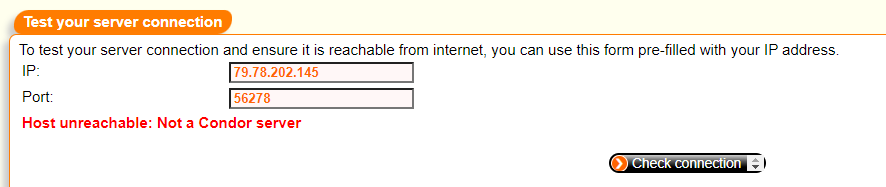

As additional info this is a screenshot from the game server I try to use (and which worked just fine before new connection and hub) and the message I get when I try to test if my server is accessible for other players.

What make & model of router do you have now? Please include screenshots of your PF rule in it. I assume that you are getting them to connect to the new WAN IP address, not the one that the old router had?
