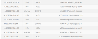

Random disconnections of the internet. Router reconnects syncing at different speeds.  Prior to thursday I'd sync around 50mbps, now it's between 45mbps and 30mbps after it disconnects

I can see it's resynced at 46mbps.  I'm assuming these are the DLM
but the others in my previous message are not? If that's the case please arrange another engineer visit.  Interesting OpenReach found an issue last time but the problems persist, I can only assume there's more than one fault.

Just disconnected.  It's not windy or raining here.  Picked up the phone and I could hear noise on the line which disappeared shortly afterwards.
It's saw it sync at 33mbps then resync at 38.6mbps.

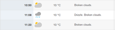

Possibly, but I've not tracked weather.  Looking briefly online shows that it may have rained at night on the 6th into the 7th, rained thursday 8th and into friday 9th early hours. Fairly sure we had disconnections on those days looking at my previous posts.
That said, saturday 10th seems to have been clear though with a possible short shower around 11:08am
but still disconnected with that phone call.  Sunday and Monday also seem to have been clear, yet it disconnected last night and we didn't make or receive any calls at 1am, nor was it raining as far as i can tell.

Can I just check, does it appear to be weather related, worse during wet weather etc?
