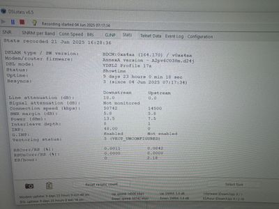

I’ve read and don’t think it’s possible but I had a new fuse board fitted and the electrician was stopping power and turning back on so loads of stop and staring of the connecting. Use to get 61ish and now down to 50. Not a major issue. Line has been up for 9 days and 22hours. SNR still at 6. Anything I can do or is it a case of waiting only.  Had 60 for years but that was at 3SNR.

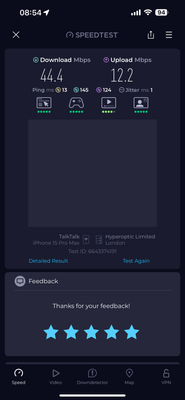

Hi there Magicukgs. Please run a speed test and let me know what speeds you are getting.
