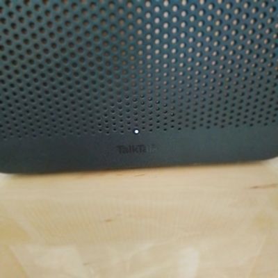

OK Feel free to share my idea with whoever has need of it: This is what it looks like , very discreet on the router. Les
Router with sunglassesRouter with sunglasses

Its very simple Debbie - I have lots of old 35mm black and white negatives from when I was keen on photography. I found one that was almost black and used a hole punch to cut out a disc of film. A little dab of PVA glue and the router now has tiny sunglasses! The LED is now about the same brightness as the outgoing Huawei one.
Job done, marriage saved...
