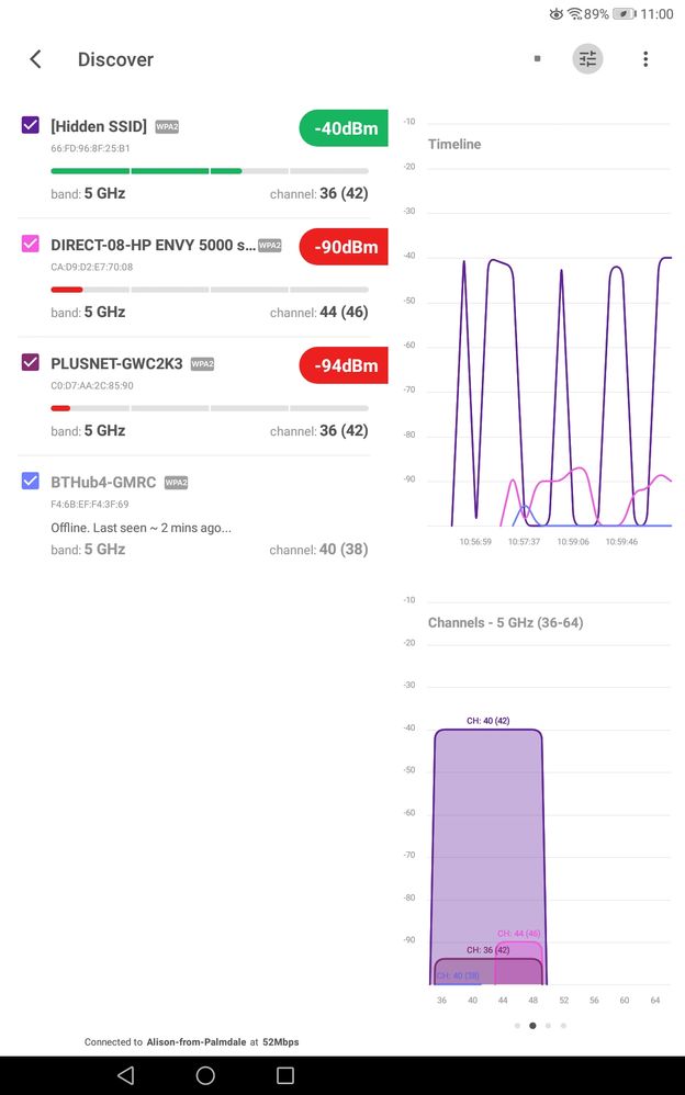

I have installed NetSpot on my android tablet. With the 5Ghz set to "ON" and Visible the NetSpot app shows only the hidden mesh back haul transmission. This appears to not be constant, but seems to be cycling aprox 12 secs ON 6 secs OFF then ON again. No sign of the actual SIDD transmission. On occasions the WEB interface Shows 5Ghz enabled but with "Disabled" below it. WIFI Analyzer also shows a Hidden transmission cycling. All very strange and similar to the problems with the old router.

No, it is not replacing it, but I think you haven't expanded your SSID in WiFi analyser to show the two APs (2.4 & 5GHz bands), which make up the two BSSIDs within your SSID.
This is a separate SSID or network that only a FAST266 can connect to. It is not available for 5GHz users.
BH_TALKTALK****** is the way that WiFi analyser is displaying it, which it probably gets from that BSSID being just before or after the BSSIDs of the normal two bands. Other analysers such as Netspot, just show it as a hidden SSID.

No, that is a special 5GHz band which came about with V158. This is a backhaul 5GHz band for the connection to the Sagemcom Fast266 WiFi Booster. When this is connected to either the Sagemcom 5364 or 5464 (Hub 2), it forms a mesh network with the hub. This will have a different BSSID (kind of MAC address) to the main 5Ghz band of your router. If you want to provide screenshots I will explain further.
