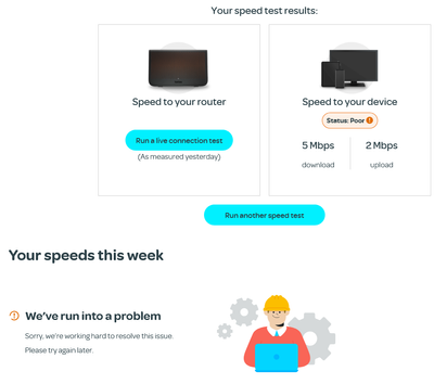

on 21-01-2024 09:11 PM
Message 26 of 71
I’m typing this on my phone on 4G (which also isn’t great here), broadband service is now unusable, frequent disconnects and only 5Mb when it is connected.

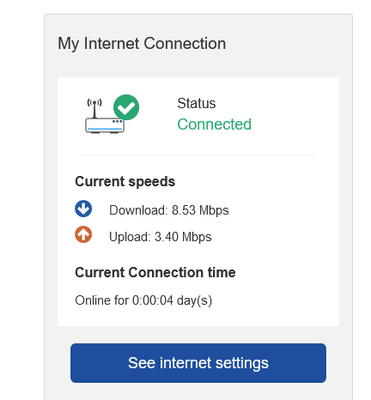

on 19-01-2024 07:30 AM
Message 30 of 71
Current speed:

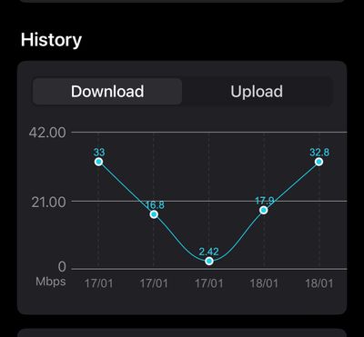

on 18-01-2024 09:43 PM
Message 33 of 71
@lockedoutagain if Talktalk needs to set up an appointment for an engineer, you need to accept potential charges.
It's worth taking a look at this now, so that you can discuss this with staff during the day:
https://community.talktalk.co.uk/t5/Articles/Engineer-charges/ta-p/2207291
Show option menu
- Mark as New
- Bookmark
- Subscribe
- Mute
- Subscribe to RSS Feed
- Highlight
on 18-01-2024 06:43 PM
Message 34 of 71
Hi, it's been terrible all day, dropping out ("you are not connected to the internet") or slowing down to unusable speeds. Could you arrange an engineer please? thanks 🙂
PS I have replaced the master socket faceplate and we are now plugged into that.
Show option menu
- Mark as New
- Bookmark
- Subscribe
- Mute
- Highlight
on 18-01-2024 10:03 AM
Message 35 of 71
Line test is showing around 35 disconnections yesterday.
Yes you can do, just let us know if you need us to arrange the engineer visit
Chris
Chris, Community Team
Show option menu
- Mark as New
- Bookmark
- Subscribe
- Mute
- Highlight
on 18-01-2024 09:57 AM
Message 36 of 71
Some of those disconnections might be me unplugging and re-plugging?
However it dropped completely about 10 last night.
Some speed tests:
Speed tests
I just got an email saying Talktalk has complete a line test - shall I give it another day to see what happens, then call the engineer?
