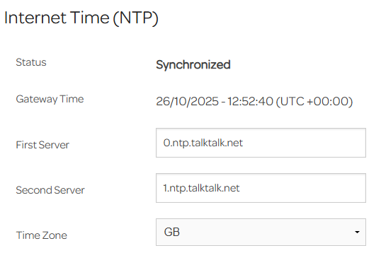

Hi @Arfer
I have checked this today & all is working well:-
GMTGMT

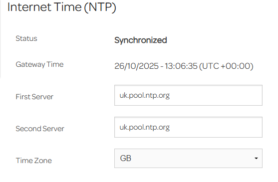

I also tried it with the custom NTP servers, saved it & turned the router off & on again to ensure that it was using them:-
Custom NTPCustom NTP
The router has been perfectly stable since the change.
I can only suggest that your problem is caused either by using a Time Zone other than the default of GB, or your router needs a factory reset.
Keith

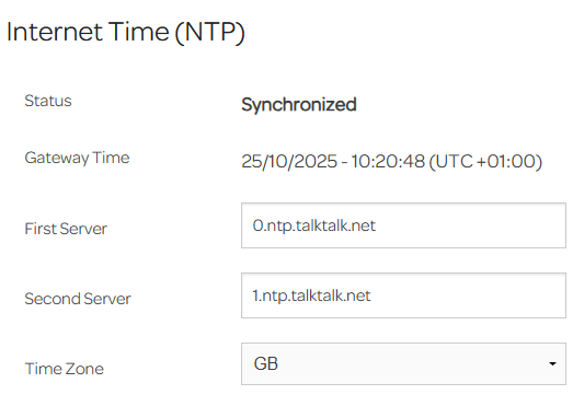

Hi @Arfer
Your time zone should be GB, that is what TalkTalk call it. Mine works fine on the default of GB:-
BSTBST
I will recheck it tomorrow to ensure it has gone back to GMT correctly. Then I will try using uk.pool.ntp.org. I'll get back to you after tomorrow's testing.
Keith

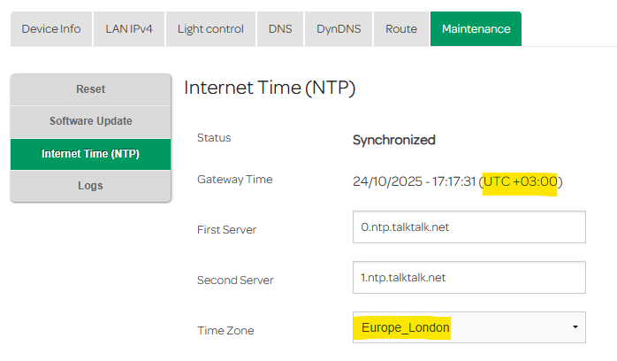

@KeithFrench Thanks for the reply. Do you have a timescale for a fix for the known bugs?
Here is a screenshot of the weird TimeZone issue:
TimeZone IssueTimeZone Issue
Europe_London should not be UTC+03:00
