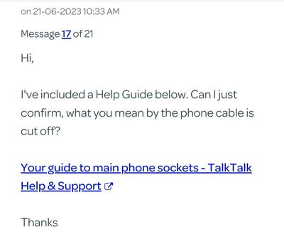

Probably a good idea if you could reply to @Michelle-TalkTalk's question:
I.e.: What do you mean by "the phone cable is cut off "?
