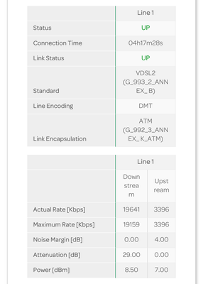

So we have just come from Sky, where I had rock solid connection for many years, at 25Mbps+ down, about 4Mbps up, with it settled on about 3dB noise margin for both.  When the connection switched on Friday the Sky router actually reconnected and the speed was similar.
However I removed it and plugged in the talktalk box.  It has connected at 19Mbps downstream, which is considerably slower than I'm used to, but the modern says the noise margin is 0!
Is this normal, or should I be worried. My account says it's day 3 of 10 for setting up, but I don't understand the 0dB noise margin which would imply it's not going to get any faster?

The 0db noise margin is a firmware bug and has been flagged previously.
If you reboot the router I'll see if I can push the later firmware for you.
Karl.

Good to see that it has connected a bit faster. Is it the same model of router as the previous one?
That speed isn't too far off the speed you were getting with the sky router, and I suspect that's probably as good as you're going to get. What is your actual guaranteed minimum?
I think you would be unlucky to get a second faulty router and very unlikely for it to have exactly the same fault, so I still have a suspicion that the 0dB noise margin is a firmware bug. What model is the router? Perhaps others with the same router could confirm whether their routers also report 0dB noise margin.
Message 8 of 35
Hi Debbie - new router has arrived... it has connected a bit faster, but has the older firmware again, but also seems to be showing "0dB" noise margin? 😕
(I think AllyM may be right!)

Thanks - the openreach engineer definitely said there was something wrong with it after he had tested everything else.  It was connecting significantly slower than he said the line was running at (and has the weird 0dB noise margin), and significantly slower than the old sky router, which I've put back in for now!
(It was also slower than the guaranteed minimum line speed)

It may simply be that the TalkTalk router just connects at a slower speed. Not all routers will connect at the same speed. Some chipsets may work better on some lines than others, the chipsets in the DSLAM line cards in the fibre cabinet may also interact differently and negotiate a different speed with the same or different chipset in the router, etc.

Thanks, engineer has been - he also thinks there is a fault with the router after testing the line etc.  So hopefully when the new router arrives, that will sort things out.
