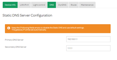

One thing that is definitely wrong is the DNS configuration. If you are using the router as a DNS server, you should really only use the router's IP address of 192.168.1.1, not a public IP address such as CloudFare's. These are the DNS server addresses that are handed out to the clients via DHCP. If you want to use different DNS servers, the correct place to do this is in the Internet Connectivity configuration area.
