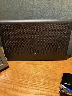

This is the router I have....
This one and it appears to be workingThis one and it appears to be working

Which router have you been sent so we can offer more specific advice?
