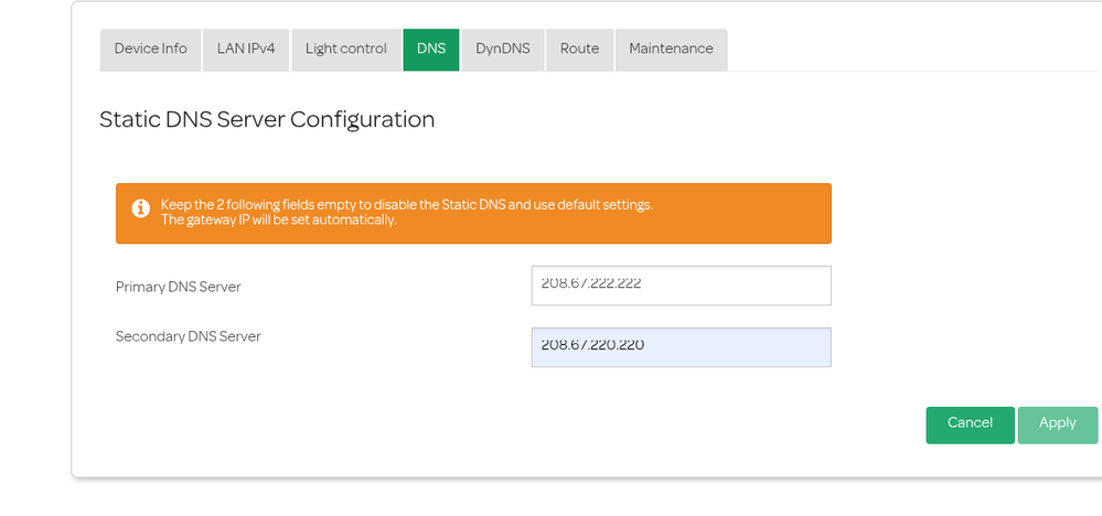

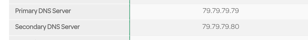

Directing Primary and Secondary DNS to their servers looks okay in server configuration page, but even though Apply button used, device info page is still pointing to Talk Talk servers.

Have noticed that despite me setting Open DNS in Router it has decided to stop working too. Wondering now if Talk Talk have overidden the Open DNS settings, albeit both are still showing when I log into router.
