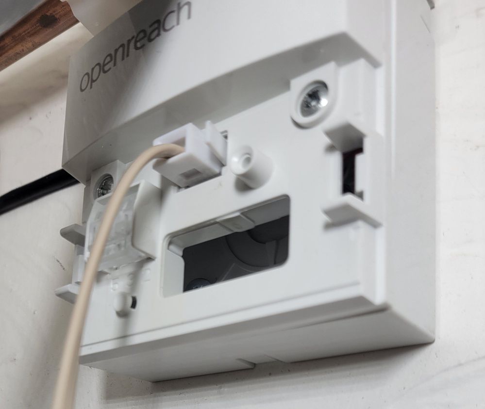

Its a BT Openreach Mk 4 so I've taken the front off it and connected directly. As you can see from the screenshot, the sync speed is now worse than ever.
on 29-11-2024 08:46 AM
Hi @philipm
Thanks for your reply.
Could you post a photo of your master socket on this thread, so I can check if you have a test socket?
