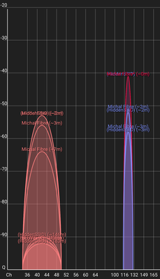

Message 10 of 31
Ok, did some checking with analyzer, pictures below:
WiFiAnalyzer(6396).pngWiFiAnalyzer(3779).pngWiFiAnalyzer(7477).pngScreenshot_20240814_194640_Speedtest.jpeg

Message 11 of 31
I am using android version of WiFi Analyzer (paid).
https://play.google.com/store/apps/details?id=abdelrahman.wifianalyzerpro&hl=en_GB
Will do as per your request and update this thread accordingly.

KeithFrench
Message 12 of 31
Which WiFi analyser?
Generally the AP view, 2.4 & 5GHz channels plus signal strength over time graph run for 5 mins. However, best is always WiFi Scanner if Windows, capturing a snapshot & report.
Message 13 of 31
Good idea! I'll test the coverage with WiFi Analyzer today when I get back home and will try to post the results here. Is there any specific information you'd like to see in the screenshots, or any particular scenarios you'd like me to test?
