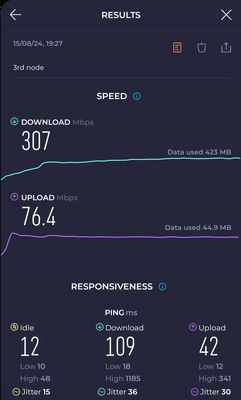

As suggested. Guest network switched off, added 3rd eero device (arrived today). Speed test results next to all 3 nodes on the bottom.
GenMaxiu

Ok, did some checking with analyzer, pictures below:
WiFiAnalyzer(6396).pngWiFiAnalyzer(3779).pngWiFiAnalyzer(7477).pngScreenshot_20240814_194640_Speedtest.jpeg
