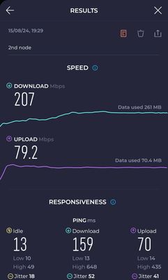

As suggested. Guest network switched off, added 3rd eero device (arrived today). Speed test results next to all 3 nodes on the bottom.
GenMaxiu
