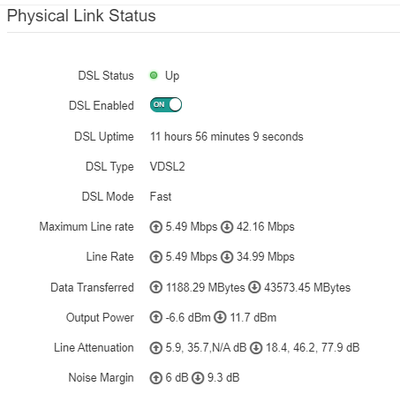

despite being on Fibre 65, I only get a connection at 34.99Mbps download (at the router), is this capped at wrong rate?

As the Maximum line rate showing is 42Mbps, but it only runs at 34.99, is it possible it has only been set up as a Fibre 35 service rather than a Fibre 65?

Email  gave estimated speed range as between 22.15 Mbps and 53.76 Mbps.
Router shows Maximum line rate as 42.66 Mbps down, but only running at 34.99

Thanks, I've added phone number the "location" field as there isn't anywhere obvious for landline.
Below is what I see on the router

It might be all that your line is capable of, @Ian_philip.
In which case, if Fibre35 is cheaper, you might need to ask if you can change the package  - check that there would be no admin fees for doing so.
