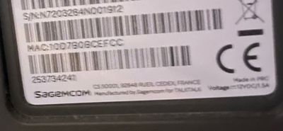

I assume then as it is a Sagemcom, it is either the FAST5364 or the 5464 (basically the same as the 5364 with e addition of a phone port on the rear for Digital Voice).

on 30-12-2023 03:19 PM
Message 19 of 21
Hi and thanks
this is the router
Show option menu
