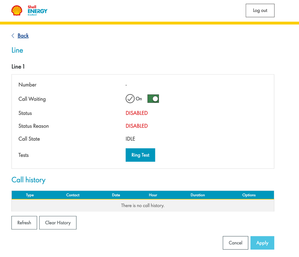

Message 50 of 107
I am assuming you mean the green telephone connection on the back of the router  (ATA connector)  and not the old analog BT DSL/phone line.   Telephony (digital voice/VOIP) services are switched off by default on routers.  The account specific details have to be provisioned (downloaded and enabled) by TalkTalk.  So you will need to ask TalkTalk customer service to do that.

Message 52 of 107
There's no connection and when I log into the hub online, which still comes up with Shell Energy, it says under "Digital Voice", "Status: Disabled" (see screenshot)

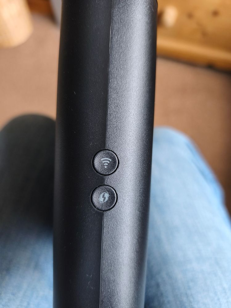

Message 60 of 107
Here is a photo of the side of the shell energy 5359  (and I believe it will be the same on the newer TalkTalk hub 3)F@ST 5359F@ST 5359
