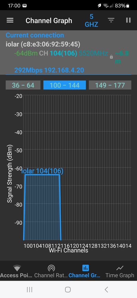

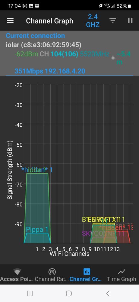

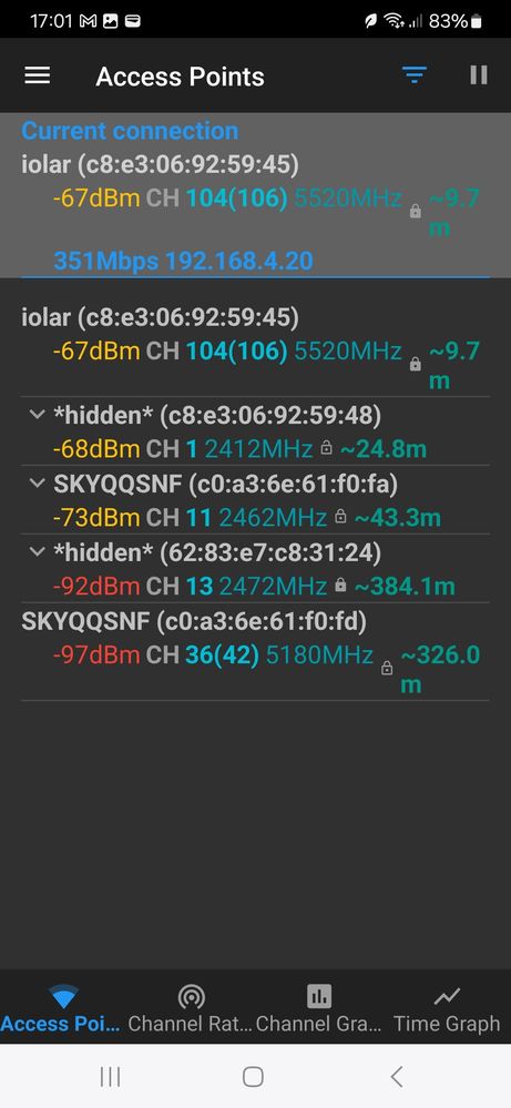

on 12-04-2025 01:09 PM
Message 5 of 14
Before installing the new Eero6 beacon I noticed the gateway had again switched to Ch104 (in the DFS band), and like my mobile(s) were connecting to that channel over nearly all my flat, with a solid 150Mpbs. After 24 hours it was still on Ch106 and a solid 150Mbps.
(Previously, while the gateway was on Ch42 the mobile often switched to the 2.4GHz with a speed of 45Mbps).
Today I installed the new Eero as a beacon the speed went down to around 95Mbps when connected to the beacon - still 150Mbps when near the gateway. I cannot find a way to determine if my mobile is on the gateway or the beacon.
I will keep an eye on it over the next couple of days.
